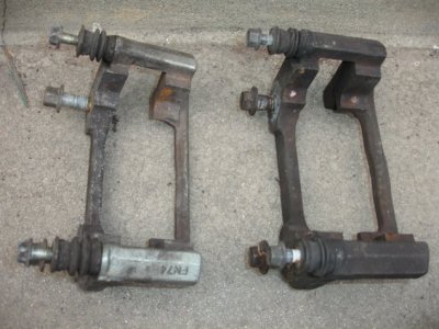

Confirmation on caliper bracket Cardone 14-1058

Indeed FN74 is clearly stamped on the bottom of the caliper bracket, has anyone used these with the 96 upgrade?

Caredone 14-1058:
vs OEM FN74 (taken from the upgrade thread):
Dsc07272

I have used them - they work exactly as the oem FN74 - I found that brake pads that fit a 2002 taurus fit the best. Other years fit but not not as well as the 2002 year brake pad.

Good enough! I just purchased two of them online for a total of $50 shipped. Can I use the slider pins and hardware from the smaller 10.9" brackets in the FN74s? Because I got the semi loaded calipers with the 10.9 hardware.
