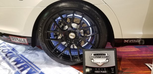

Are you running the TEC kit?
You mean "TCE" correct? If so, yes.
4 piston caliper at each corner.
Massive 15" drilled/slotted rotor up front.
Same for the rear, except in 14.25".
On a side note, Todd Cook, owner of TCE provided the technical reasons why a 6 piston set up was overkill, I just don't remember what those explanations were/are, as it's been so many years that have passed now.
I had inquired specifically about a 6 piston set up, and that's when he provided his rationale.
Regardless, still gonna be neat to see such a set up as you've proposed here, in action.
