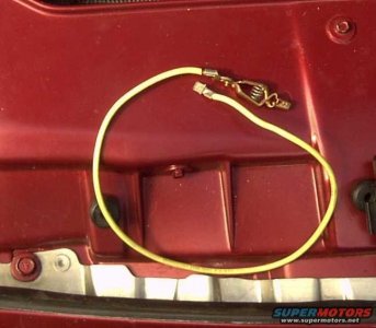

If you leave the key off and turn the motor over by hot wiring the starter relay then the FIs will not turn on.
Hot wire the starter
Starter hot wire

so will the engine crank automatically when i hook that wire up, or do i hit something else after the wirs is hooked up to actually crank it?

Yes it will crank. I plug the end into the relay slot then use the clip in the end to bump the starter.
