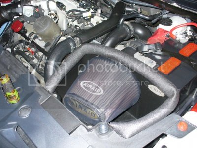

my attempt to solve seal problem of the airaid, sits up more & could get it around whole length of the boxCainewstrip zpsb39d286a & unlike the rubber folding over just compresses when hold down. no real tests if it works but anything's better than the rubber tubing airaid sends.in addition to me makes looks a lot more finished.

brian:
you & rich did the same thing i just stole the idea from you guys. i was thinking once i found that the tubing works to put the rubber strip back on & put the tubing on top of that to make an even better seal, but got real cold in stl this weekend. at one time thought of doing the hole in the side & trying to grab some more air but not as mechanical as you so gave up the idea, but i like what you did a lot. i was thinking of going to wheel well area so would kind of be out of sight, but couldn't find any air coming from there. cover is off ready to run my 89 out of her for 93 lme 4x tune so she'll be ready for convention. i really like ahmad's cai but unless can sell will have to wait. as far as DP's big mac is right. you don't need any gauge to know that the low end torque is much higher. she just jumped off the line in mexico run. my friend with the chally was with me, blew him away enough that he had to tune his/mine r/t to keep up. can't wait to see his '15 r/t scatback sublime green w/ shaker hood come in, but that's another story. tuning the sho for convention & his scatback. friendly rivalry between us for a long time. old tennis buds, now both back to original love cars.

Too bad you don't live close, I'd do the Tstat and plugs for you. My flex pipe pulls air from the lower grill then routes up thru the fender. Its tight behind the drivers head light, but works. I put a crappy old box fan in front of the car and could feel air coming thru. Any extra air is good.
