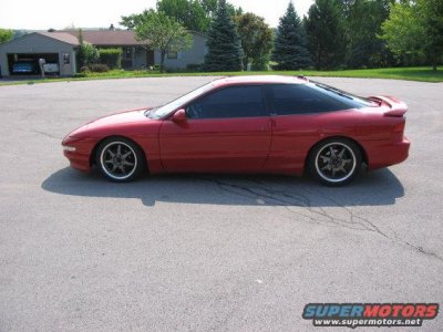

they certainly are nice...if you get a good set. mine are 2-2.5 years and have 17k miles,and have been blown for about 5k of those miles. my ground control/koni setup on my svtc is still great after 6 years and 38k miles.
heres my pgt w/them,this isnt even lowered all the way,just basically the strut body is lowered allowing full travel of the strut rod.
