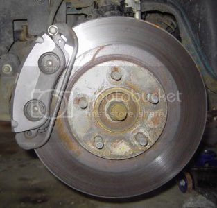

pic:

My set up:
Pbrs

In the pic of the brackets, you see how the left one poltrudes? The right one is milled down flush with the rest of the bracket.
Also, if you do this, get cross drilled or sloted (or both) rotors. I think I actually was able to warp my solid rotors.

Thanks for the pics, those help a bunch.
I know that the Mustang calipers must be swapped Left and Right to allow the bleeder to be in the proper orientation, but what about the brackets? I assume the brackets go on the correct side (no swapping) since they're probably designed to take force primarily in the forward direction.
For aggressive street and maybe some light track duty, will I see any difference with the PBR calipers over the standard 96+ SHO calipers? I like the fact that the PBRs look better and are lighter (right?), but do they actually perform any better with the 11.6" rotors? Is pedal feel improved?

The brackets are the same I believe. I had the 96 upgrade on and I wouldn't give up my PBRs over the 96 upgrade any day. There's a big difference in stopping power and pedal feel. The PBRs are quite a bit lighter too.
