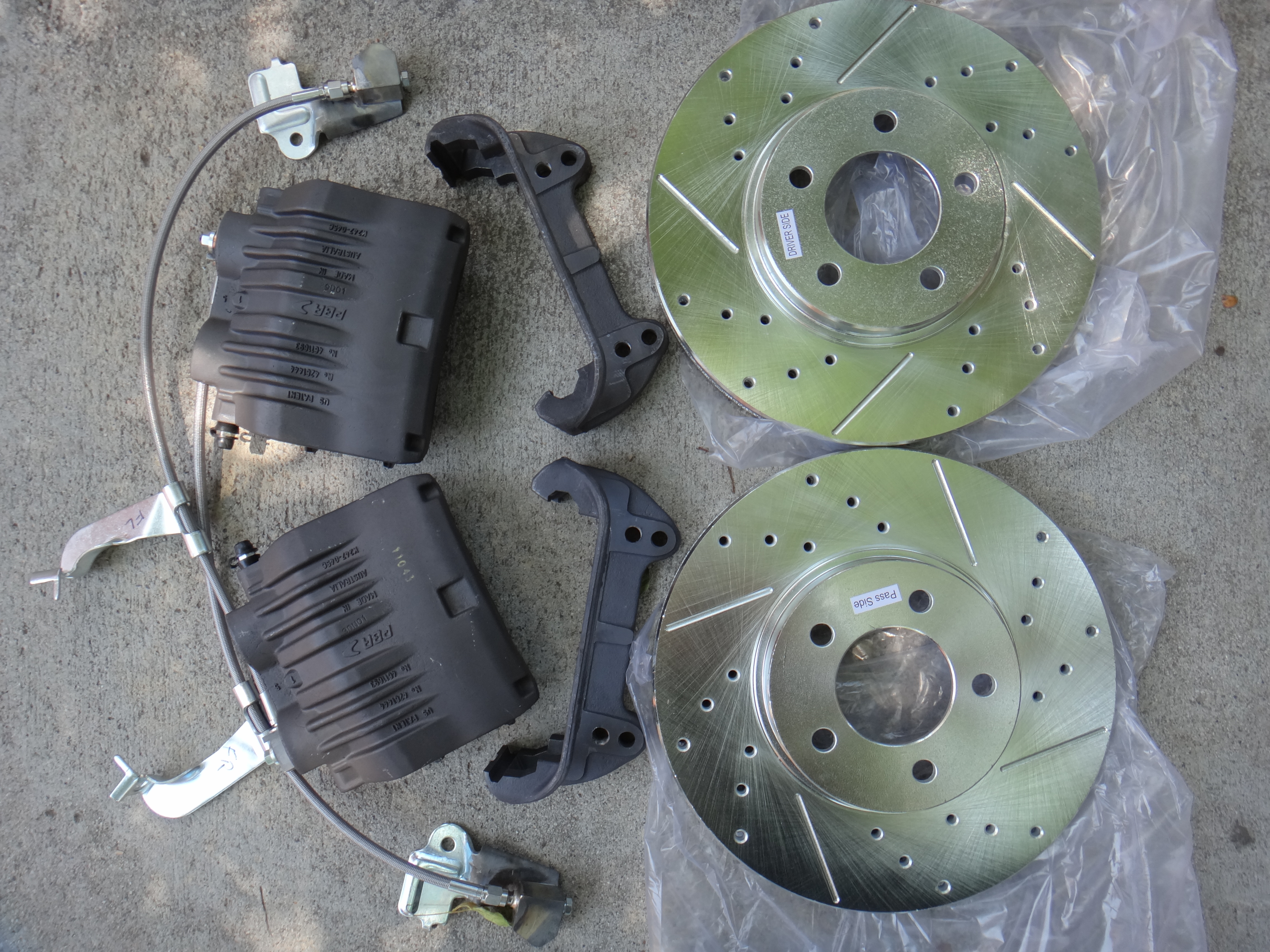

Baer used to sell (and maybe still does) brackets modified for 12" rotors (you would use redrilled or slotted Crown Victoria rotors). They also came with a spacer and were $74 each when I asked a few years ago.

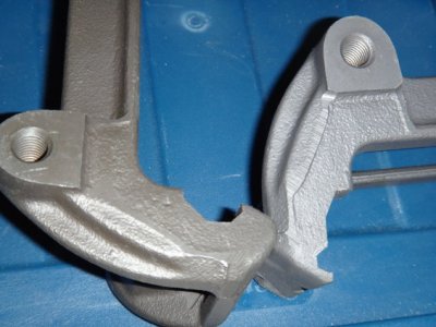

Baer12PBRBrackets 002
This is the Baer modified brackets for a 12" rotor, the only difference is you'd want to drill the holes up a bit higher in the bracket for an 11.6".
