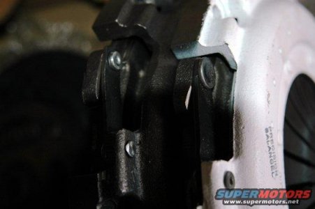

My SHO is setup about the same and I use a CM stage 1.
The CM is on the left and the stock PP is on the right. The CM has larger straps and larger rivets.

Well next week turned into a year, I finally got my pressure plate out, and am busy putting in my new clutch setup. I took some pics of the pressure plate and bands, this one did better than the other pressure plates, only one band smashed. (The others had two) But I babied this one, I did break it on a trip up the coast.
I am assured that the DXD pressure plate will suffice, but man, what a PITA this has been, so I am posting this to hopefully help the next guy with this issue.
I can only attribut it to a High horsepower engine and my driving habits.
Here is the pics:
