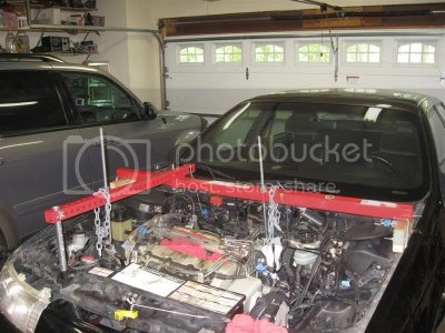

In case anyone is interested, here is a picture of the support beam I purchased from ebay. I did not use the cables that came with it, and I doubled up the attachment to the engine with safety chains. It worked out very well; no problems at all. One thing I like about this one is it folds up compactly, taking little storage room. After I figured up the cost of materials to scratch build a support, this was a better choice for me. YMMV.
