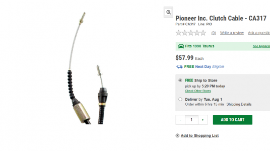

The one on the O'Reilly's site is also incorrect for this model. SHO Source must be using the same one.

I don't see anything wrong with it. The inner and outer cables are both the same length. The only difference I can tell is that the bellows are shorter on the new cable.

Well it'd help if I wasn't an idiot. The bellows are shorter, but I was worried that the clutch pedal side wouldn't reach because of how short it is, and the cable was clamped. Well, turns out if you hold down the clamp and pull on the cable, it actually pulls through!
