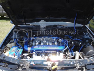

Odd, I've got a painted intake that quite a few people at the convention thought was pc'd.
Talk is one thing, pictures are another!
It's like the girl at school who thinks she's hot stuff because her friends tell her she is to not hurt her feelings, but in reality she needs a make over. :rofl:

Looks even better when it's clean.[/QUOTE]
Much nicer than A new one too!

It does look better than 100% painted intakes. How many miles do you estimate you've put on it and did you use a spray gun or rattle can? Most start off looking good then fade out, or just look like flat paint from the beginning.
Sep 6, 2002
2,351
Westerly, RI

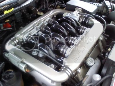

I installed this right before the convention, so probably about 3-4k miles on it. My previous one, which I'll post a pic of also, was on the car for about two years and probably 60k miles (I drive a lot), and was still shiny and stuff.
Both were rattle can, paint and clearcoat. Parts were cleaned, bead blasted, primed, and painted. Scotchbrited and tack ragged between coats, especially the clear. One coat of primer, two coats of color, and four coats of clear. In all, probably about $20 worth of materials. Probably about 5 hours of labor to paint, but I did it between tasks at work so it worked out well.
PC definitely is the way to go for longevity, but I find myself getting bored with color schemes and wanting to change things often, the paint works out cheaper in the long run.
