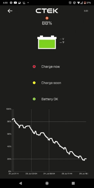

I've had a similar issues you can use forscan to but it in inop mode that seemed to fix the issue for awial I went all summer without needing to charge the battery but see the history the battery got really low I need to start recording by truck battery to get a view of what a non smarter car battery looks like.
the battery management is turned off and I still feel the battery should get more charged then it does the uptick is a 6 he drive to Anchorage my time there then 6 hrs back then put it on the trickle charger
