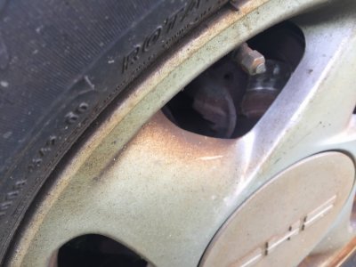

The car did have low mileage, but the previous owner had hit a deer with it and then let it sit for almost a year. So when I had got it the front two spark plug wires had corroded and rusted out (no dielectric grease was even used). The car from my perspective had three maybe four owners. The first who had it for 24k miles, the second that had it for around 60ish (this is the one that kept all the detailed maintenance logs), and then the third who had it for around 20k ish miles and struck a deer then left it sit as he was unable to repair the damage. Then finally me. When I got it the car was in... well poor shape. The passenger rear brake rotor was so low and thin (my god it was almost paper thin!), that the brake pad had actually slipped out of the caliper and wedged itself between the caliper and rotor blowing out the caliper piston seal in the process.

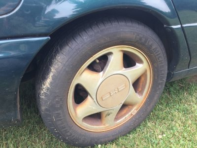

The front driver side was smashed. Quarter panel, hood, bumper cover, headlight bracket and all the headlights on the driver side was destroyed. Even the radiator support frame was bent a little (tried my best to straighten it out). As for getting plug wires? Discontinued. I tried NAPA, Autozone and my local Ford dealer (New Holland Ford), thought I should have realized asking Ford was a stupid idea. I could have gotten some plugs, but all they were offering was some cheap China plugs like Duralast or some low quality brand from NAPA. I settled on SHO Source and a set of Taylor Thundervolt 8.2mm wires and some Autolite iridium plugs (they were the same price pretty much as what was offered at the parts stores anyways).
