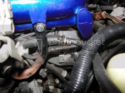

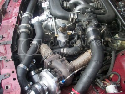

Well it isnt really hard. The only one that needs to be filtered is the pcv. If you put one on the valve cover nothing will come out. For boosted cars this is a different story.
Here is mine.
108 0077
You really just connect the pcv hose to one side and the other side to the bottom of the TB.

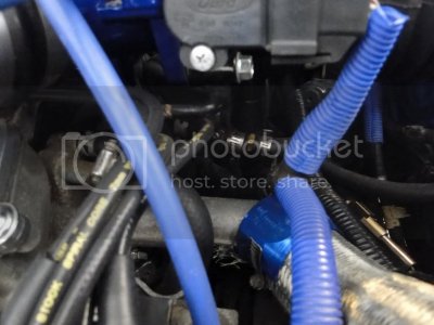

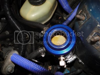

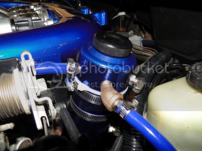

We had the catch-can mounted where the ATX Cruise Control computer is for a long time, and that worked pretty well, except for there not being any cruise control.
DSC016811280x768
DSC016851280x768
DSC016791280x768
DSC016781280x768
And it catches a lot of shit, too. This was after a week or two of short trips, and directly following a long 50 mile trip to fully warm the engine up. This is why short trips are bad for an engine. It's aerated, condensated oil.

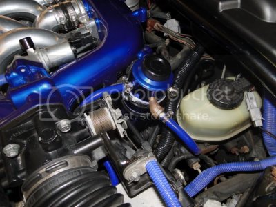

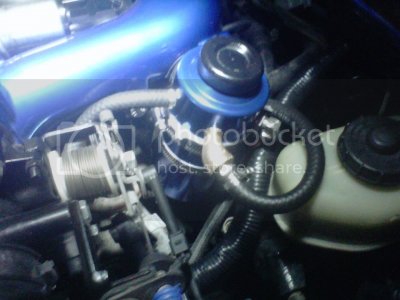

Then, she decided she wanted her cruise control back for a 4 hour trip (understandable, I feel) so she moved it, using fuel line hose, to its current location (pic via blackberry):
IMG00205 20100923 2051

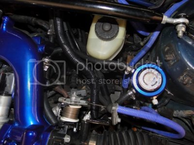

Then, she got a set of firewall vacuum hoses, and she found that two of the big ones aren't used on an ATX, so... new catch can hoses!
DSC022621280x768
DSC022641280x768
And she has done 100% of the work on it. I just bought her the parts. ****, I haven't even been in the country for most of it.
