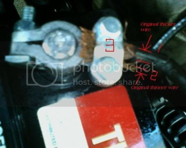

Both are hooked up it's just that they've been spliced. So my negative ternminal is like this =O---==== instead of this =O====. Is that a problem?

if u mean it goes from a smaller gauge wire to the stock gauge, yes it could be the problem....could mean your not gettin a good enough ground
if thats what you mean id defiantly c if the stock wire would reach the terminal, if not theres 3 options i c
double or triple up a smaller gauge to get it near the stock gauge, get a heavier gauge and replace the smaller gauge out, or just run to advance or autozone and buy some battery cable and replace it all..........
id probably do the last if i had the s[pare cash on me at the time.........after this many years the stock wires are probably pretty gunked up and worn

The wires are the same they cut the factory terminal off and replaced with a newer one (#3) but the wires (#s 1 & 2) that were seperate now connect at the terminal (#3). Here's a very bad camera phone pic

i c what u mean now...........i ran mine the same way when i changed out connectors (original was badly corroded and cracked)
so this "SHOULDNT" cause any problems........i havnt had any because of it yet.......

SHOtime3, your setup is fine. The wire goes straight to the terminal, as it should.
Now, having said that, your battery cables (both of them) are anywhere from 13-18 years old (old enough to smoke!), and this means there is a lot more resistance in them than there should be. The cables are easy to replace (once you get the wire-wrap out of the way) and will give you a great power boost if yours were as bad as most are.
