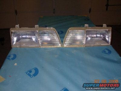

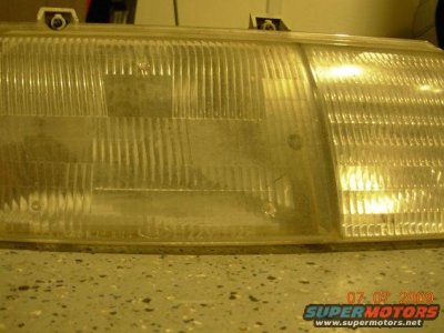

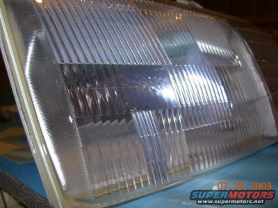

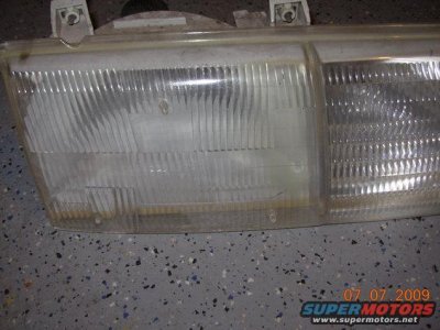

That should sand right out. You will have to sand a good amount of material though. I would suggest starting with 600 or 800 grit paper, then move up in grits until you reach 1500 or finer, then polish your lens with any rubbing compound. The bad thing about polishing the leans is that, the lens itself has no protection from the UV rays, and will yellow out over time requiring more polishing time. The best thing to do is spray some clear over the repaired surface. They did come with a clear coat when new.
Here is what I did, on the lights for Project 195.
I started of with a 600 grit, then 800. After the 800 I sprayed two coats of Sikkens automotive clear. I still need to do a light wet sand to remove any imperfections. This method should last a few years.
