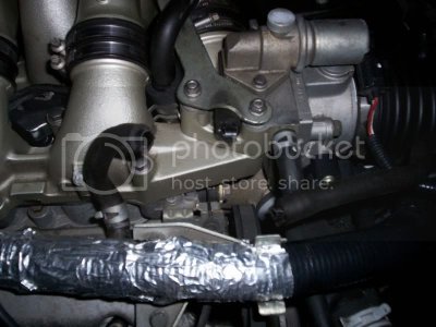

Nocover
With no Vanity cover. Shows the IMRC that needs to come off, the harness, and the hoses going to the cover.

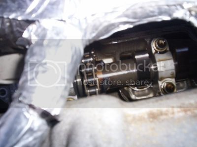

Camweld
Mine has 4 small beads on each sprocket.
