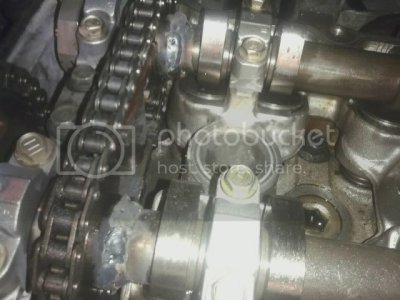

ok here is a couple shot of a weld from today. as you can see the weld on teh nut looks good but the one between the nut and the sprocket are not so great. could this be caused by an incorect gas mixture?
Badweld2
Badweld1
thanks for all your help so far!

Bob and James are spot on. You'll always get a little bit of oil contamination causing a couple of spots, but the ArO2 combined with a wire that may not be best when you consider that the sprockets are a different metal than the shafts and nut are probably contributing as well.
Sep 6, 2002
2,351
Westerly, RI
Im with stupid. Thats waaay too much argon. Would be a decent combo if you were welding aluminum though. :wave:
Actually, the argon content isn't so bad, it's the oxygen that's going to make the weld brittle and porous.
Oxygen isn't recommended for use in any aluminum welding, because it oxidizes the weld.
That 95/5 would be good for stainless though.
Now, onto the weld appearance. Since it's already done, and it seems that at least some of that bead is good, I'd leave well enough alone. Keep in mind, you're not trying to hold the sprocket radially (unless it's already slipped), you're trying to hold it axially, which requires much less weld strength.
IMO, going in there with a die grinder to get that bad weld out is going to do more harm than good.
Also, Chris, the wire he stated as ER705-6 is most likely a typo, and is actually ER70S-6 wire, regular ol' steel welding wire. :)
I definitely agree though, the different hardnesses of the components makes it a little difficult to get a good setting until you've done a few. I've never done any actual "cam welds", aside from messing around with junk cams.
To the OP, switch gases to 75/25 Argon/Carbon Dioxide, turn the heat up some, and you should be fine. Oh, and make sure the polarity is correct on the welder.

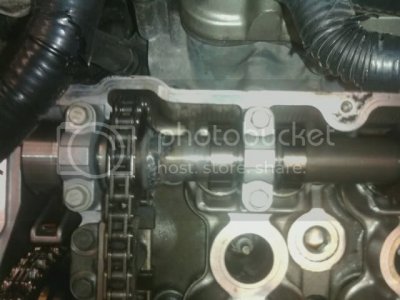

ok welding is done. they ended up welding it solid all teh way around the cam... i guess they wont break...
Finalweld1
Finalweld2
Finalweld3
Finalweld4
it just needs to be cleaned out and put back together now.

that much heat could actually make the cam weak, but it does look solid.

Turn the engine over by hand with a socket on the crank pulley. Make sure none of the welds are interfering with anything else. Run one of those telescoping magnets through the head, blow everything out well, maybe splash some oil on the cam lobes, and put her back together.
