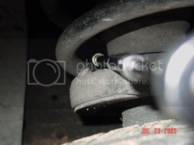

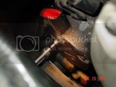

Is this on an ATX or MTX?
The atx is easy to get out..
however, the mtx is a pain in the ****... especially the rear/bottom bolt.
I found a way to get the rear bolt out really easy.
Tools:
1/4 rachet.
a few 1/4 extensions, or one long one. (youll see why)
and a 5.5mm or 7/32 socket
Pics pretty much some it up.
DSC01077
DSC01073
DSC01072

It is an atx, do you know if there are any detailed instructions out there.

If its an ATX, its really easy. As you have more room because the motor is mounted farther forward.
