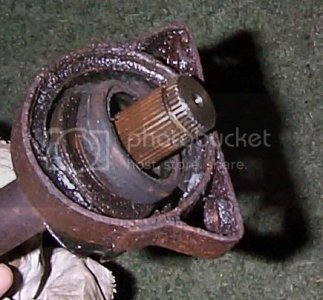

Sounds like your rear cam seal let loose. It will drip down the engine and land on the catalytic converter...where it promptly vaporizes.
Since the cam seal is at the very "top" of the engine, it only sees oil when the engine is running...therefore...no oilspots in parking spots.
One way to diagnose this is to jack the car up and have a look at the intermediate shaft bearing. The passenger axle goes into the intermediate shaft and that goes into the transmission. The bearing you are looking for is about the size of a hockey puck and is bolted to the power steering bracket. If it's wet with oil, then you have a cam seal leak. Here's a picture of my old intermediate shaft. It had been absorbing oil for the last 70,000 miles and finally let loose...
