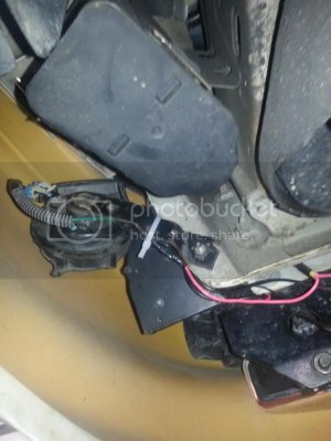

20140331 164720 zps5c7a05dd
That really does open up that area. Lol. I ended up mounting my horns in a different location then I originally thought
