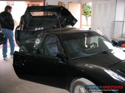

Kind of like this GT-40 with a 3.0 SHO and SHO MTX?
21008togglefullsizefright20side20open20hood
It's built on a Fiero chassis. I have more pics if you want.

lol Tom no offense but thats a pretty bad picture :) Got any that show the motor in the car?
