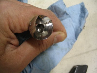

here is an idea that worked for me. in the first photo, you can see the valve cover bolt that I stripped, then broke off the ez-out on. more attempts at drilling did no good.
Valve cover bolt1

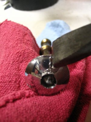

after several hours of unhappiness, I applied some basic physics. Realizing that there was a potential level arm from the center of the drilled out bolt to the bolt edge (large flat top), I used a hacksaw to gouge out a notch near the edge. Then an old chisel and hammer loosened the bolt by tapping it counterclockwise.
Valve cover bolt2
best of luck.
JD:salute:

JohnDallara, it sounds like he already got the bolt out.
To the original poster: The solution sounds pretty simple. Just use a larger Helicoil and larger bolt.
