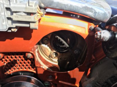

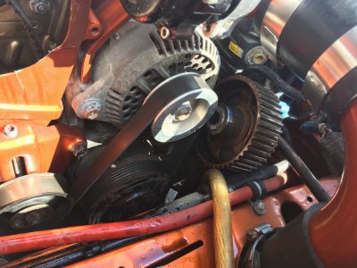

Driving then this happened. 8a72e9fcda365d599fcfd066017c4fbcF9db8255f0c4bf6b0e6dda0070da3a54
Not sure what to make of it. These are the +40 regrinds. Been on the car for a good while. I’m going to go back to stock ones if after I pull the head everything looks good.

Yes, but not tuned yet. Been braking in the clutch because it was slipping on the dyno.

Yup I’ll see what the damage is soon. Haven’t ripped into the engine in a while.
7,521
The only time I've seen that is from a timing belt too tight. Since yours also happened on the tight side of the belt, I would suspect the same thing there.

I assumed the same thing ... fortunately I save the original camd

All of the V6 SHO motors are non -interference motors so you should be good internally unless something internally went wrong and caused the breakage. Looks like a clean break, replace the seal and cam and crank her back up! i know, if only it were that easy....good luck brother and may the damage be nill! o_O
