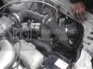

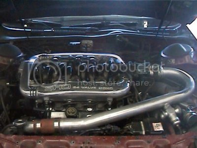

well mine that we just started on yesterday, is a GT42 turbo off a deisel, and 50lb injectors, 255lph fuel pump, adjustable fuel pressure regulator, intercooler,80mm mass air meter,twEECer, (plus) stage II cams, Ported and polished heads, EH intake and a stage 4 racing clutch..and 3" exhaust
no pics yet!!!!
that one is mine, ashley
my fiance, paul, also has GT42 turbo, intercooler from a deisel as well, 42lb injectors 190 lph fuel pump stage 2 racing clutch plus 3" exhasut. we took out the Fidanza flywheel because it made 1st gear spool up too fast.
here are some of the first pics
Engine7
Engine6
Also, we did experiment qwith a thunderbird Supercoupe supercharger on mine first, with an FMU and 30 lb injectors. but the jackshaft broke. :)

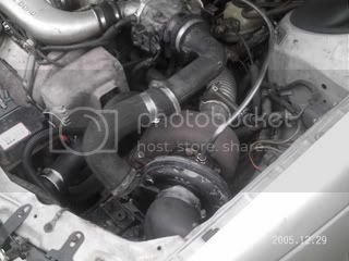

here is also a pic of our friend justins that we boosted for a while. just a quick shot of it though. I think it was a holset turbo and 38 lb injectors.
