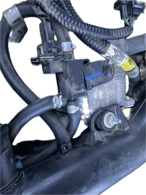

Recently replaced the water pump
And can not figure out where one of the lines connects there is a ****** end in the frunt side of the charge pipe that has a hose that some how ties into the boost lines some where the solinoid it self has three hoses that come off of it one that goes to the front turbo and the other runs to the back turbo the third one connects to the solinoid it self and runs to another conection on the same charge pipe any help would be greatly appreciated hanks in advance.

Are you asking about the attached? The zip tied hose?View attachment 96838
Yes that is what I'm looking for however there is another line that comes off the front of the that charge pipe that I can't find the connection for it but aside it looks as though I've got the other ones correct. I had thought that it maybe T into one of them existing ones somewhere but I'm puzzled.
THe other issue I'm experiencing is
On WOT I don't have the power that I used to before I have also replaced the front turbo about a month ago but things deffinatley. Don't seem normal as far as it not having any power.
