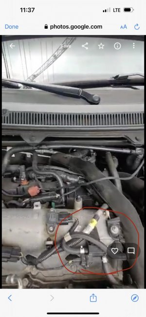

Here you go guys, everything is rock solid connection wise, even the front wastegate line is good.https://photos.app.goo.gl/NzNnWrWf5jyavvrw7

Yea will give this a try as well but vacuum hose on the front is on there, you'll see in the picd

There are a couple of picture in that link.
Yea the front one I was able to get, rear since the pic is zoomed in so much kinda hard to locate it but will dig around and see how close I can get

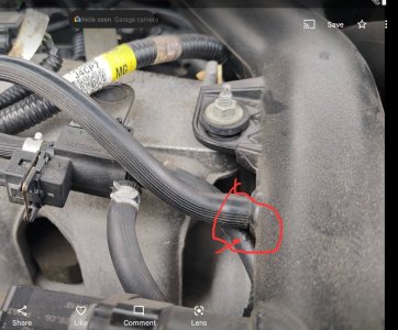

See the oil under the hose coming from the Garrett pipe, you sure it's not leaking or split?
