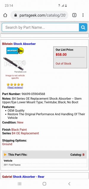

Just found this website that lists some B4S not only for an incredible price (prolly why theyre out of stock), but says they fit a 2011 SHO, this is just the rear though
2010 SHO PP, axle back exhaust, 3 bar MAP, upgraded thermostat, iTSX tuner, 20" summer rims
525b7a79846ea56944f2035d3ede3981
If you can find the B6s that fit, I'd recommend those, especially if you're lowered. The B4s are OEM replacement.
