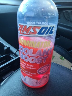

For your overheat issue. Try this. I had the same issue in the humid heat and this took the problem away for 2 years now.
Resized 20210330 151728
