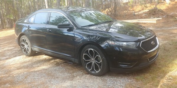

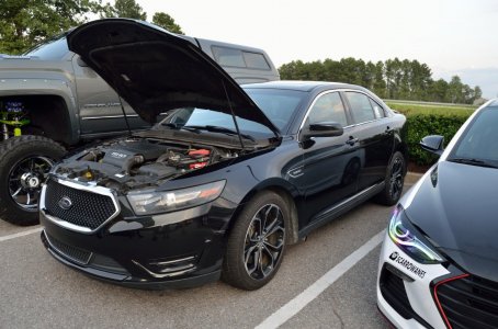

So it's been suggested to me many times to put everything in one place, so here we go.
F69KGPo
Started with a basic 2013 SHO. I made the mistake of using LMS for tuning, and pretty soon after I was having the shift issues they're famous for now. I pretty much spent a year untuned due to that.

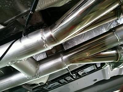

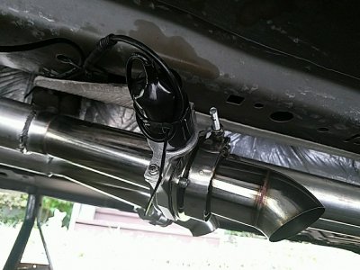

I think one of the first mods I did was electric exhaust cutouts, but after a while I realized I ran it open more often than closed and decided to just make it loud all the time.

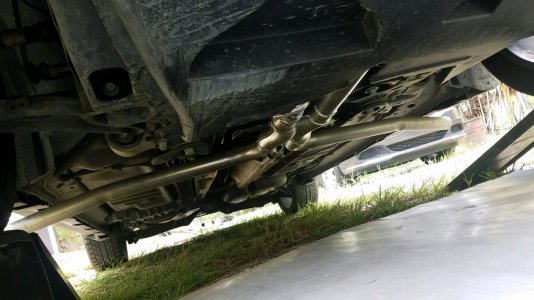

YPTHGW7
This is where it went next, I wish I'd stuck with an H pipe but otherwise this is way quieter in cab and still has a ton of turbo whistle.

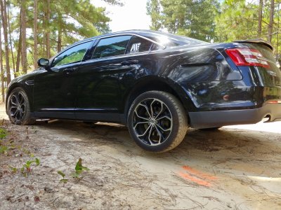

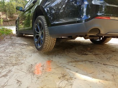

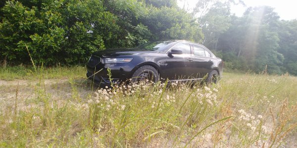

So for some context, my driveway is a bitch. It's torn up cars before.
81Aj4G3
M80Vg8u

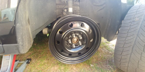

So that's when I started thinking about the lift, but I knew it'd look silly on it's own, so I started doing some research.
BqW42LQ

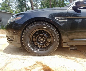

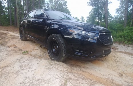

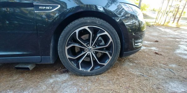

Test fitting a 17" wheel. After adding a 5mm spacer it worked great.
JLsZAVB

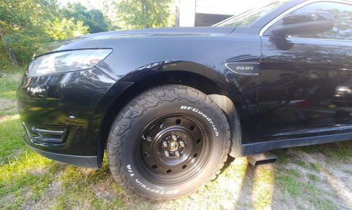

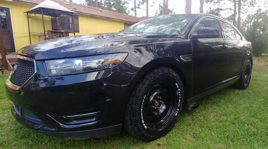

And then we ended up here. 245/65R17 BFG A/T's. Just a hair taller than stock, so the speedo is happy. Turn in takes about a week now, but the ride is so damn smooth compared to the 20's and rubber bands.
30optvu
And this was the last time it was ever clean.

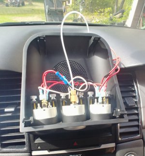

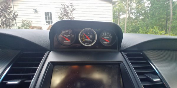

Like gauge pods! Shoutout to bpd for helping me wire up the tranny temp (it's super easy)
I3Br3n6
With some spaghetti. I'm an electrician, trust me.

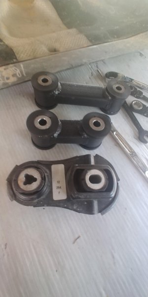

The SSM torque mounts were a huge improvement, I'll always call this a day 1 mod.

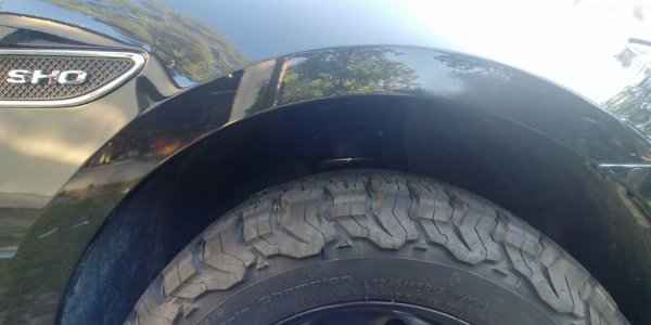

So now wer get serious with the lift. I tried explorer struts, they won't fit. I tried explorer springs, turns out they're the same as Taurus springs. Explorer struts would give 1.5" of lift with clearance for larger tires, but I think I'd need explorer control arms and such.
8ihHJDA

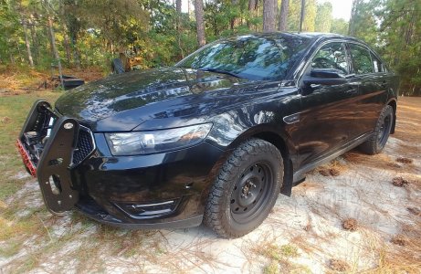

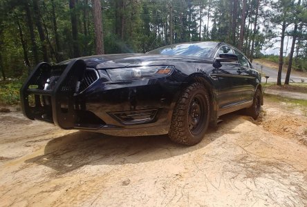

Now that it was lifted, and had the tires, I figured it was time to make it more aggressive. I don't like push bars on street cars, but I wanted to try it on this and it turned out way better than I'd ever expected.

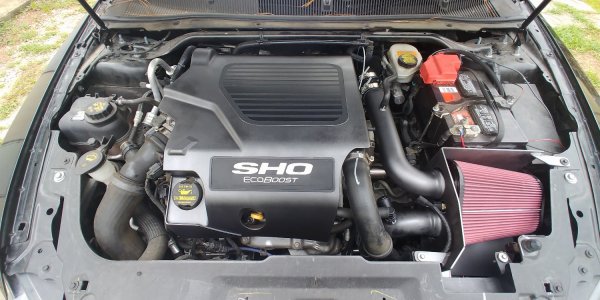

I also got one of them nifty EPP intakes and painted it with Ford Gray pain, and did the engine cover to match.
LpAZoJG

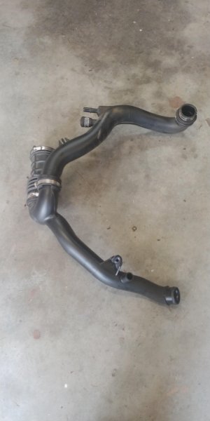

This is the factory pipe from the intake to the turbos, replaced with independent aluminum tubes with mandrel bends. EPP is the only intake worth doing IMO.

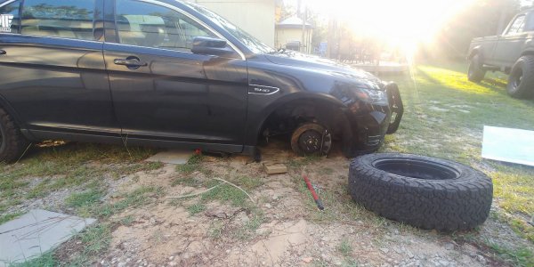

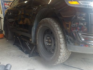

So I was trying one of these, and I got run off by a rain storm. When I came back, the ground had eaten my jack stand (the bit of red under the door.) This is when I took a break for a bit, and was actually running two different front suspensions on each side.
IkMOAi3
So I got a quickjack. If you're looking at one, and get it, throw away the rubber blocks it comes with and get some 4x4's instead. Lay them down longways and put pinch weld blocks on those. It fell off 3 times in a row with the rubber ones, they just suck. With the wood it passed the shoulder slam test (which you should always do, if you don't trust it to stay then you shouldn't be under it!)

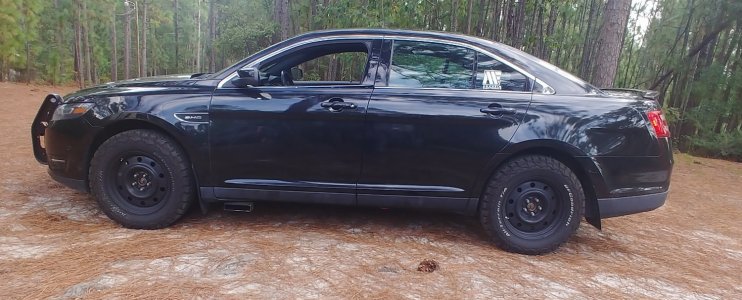

So now we're here. This is with an explorer lift kit up front, which is 2" strut spacers and sway bar extensions. It mostly dropped in, took a bit of opening on the strut holes on the body but was otherwise simple. Ride is back to factory quality, and once I get an alignment it'll be all good.
A7hg6t4
Balanced stance, with no more rake. I think that's everything for now.
