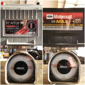

Probably overkill for most, but DAMN this thing is lightweight...
600$ greenline?? (I think thats the brand) Lithium is overkill but weighs 6lbs. But 40lbs lighter has no con other than cost
No, I wanted closer to factory Ah rating...Got one of their Intensity batteries...closer to $1200 and weighs 11lbs...but gives me way more juice than the Greenline...
...nothing but the best for my baby, LOL...

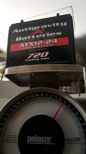

Yup...can do it just fine...as a matter of fact, many jump packs are lithium...
...as a matter of fact, I have one of these in each of my cars. It has been a lifesaver on a number of occasions, especially on the wifes car. She can do it all on her own without having to flag someone random to help jump her car. I've used it a ton on my tractors and riding mowers too, LOL. Fits right under the seat of all my vehicles. Don't mess with the cheap knock-off ebay/amazon brands...go with AntiGravity on these...trust me, the quality is unparalleled. It's cranked over my F550 work truck without skipping a beat, a number of times before needing recharging...so it works...
