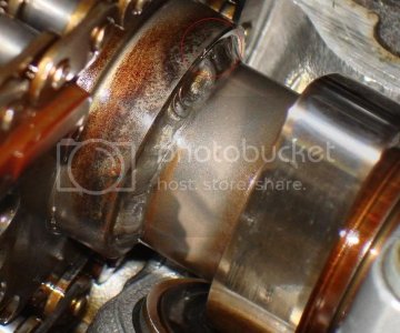

Hoping you v8 guys can lend a hand here. I have to do a tune up on my cousins 98 SHO. And was wondering if the valve shims needed are the same as for the v6's? Also does anyone have a picture of a before and after shot of welded cams?

The shims are the same, but they don't seem to need frequent checking like the V6's.
Here's one of my welded cams:
RearHeadExhaustCamCloseup
