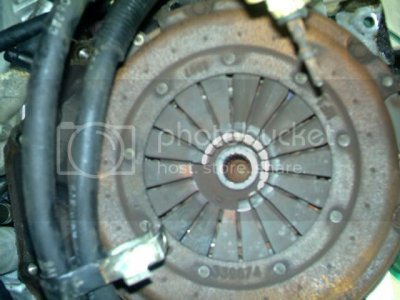

Well you sure as heck got your money out of that one.. Looks like 5k of driving with a bad clutch.
