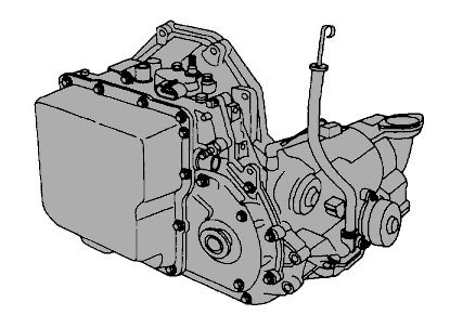

can someone tell me how to add tranny fluid in a ATX? ...my tranny seem to wanna shift whenever it feels like ...sometimes when I mash the gas it a go to 7K then actually peg out a lil bit the it a drop back down and lag out like it almost won't catch and shift into 2nd but it varies dependin how I accelerate but I had a few times where it wouldn't shift at all it would just climb gradually any ideas ???

Add fluid only after checking the level to see if it needs it. The fill hole is the dipstick hole. But your issue sound like it could be a VSS sensor. Check your codes, check the "how do I section" for help getting the codes if you need help.

Thanks but I didn't see anything for the codes in that section
