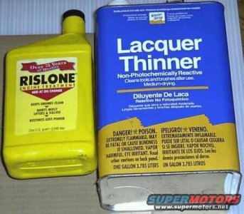

Soak it in lacquer thinner until it swells to your liking then immediately soak it in Rislone for 24 hours.
Rislone  lacquer thinner1

I think I will try that. I took my old one apart over the summer just never got around to rebuilding (new baby no money etc.) What type of oil/fluid should be put in the tensioner?
