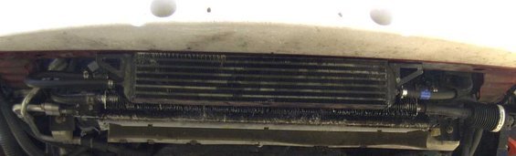

No real modifications necessary, aside from mounting the cooler. I mounted mine to the underside of the front bumper. Only downside is the metal on the bumper is super-hard, and it's difficult to drill into.

The gen 2 cooler is a perfect fit to mount under the metal bumper. Hard metal to drill into so start with a small bit and work your way up.
The radiator cooler can be eliminated. Just loop the passenger side of the OEM aux cooler and the g2 cooler together.

There are two hoses coming out of the tranny. Connect one to the drivers side OEM aux cooler, loop the pass. side end of this to the pass side end of the g2 cooler. Then g2 cooler drivers side back to the tranny.
You will need about 5' of 3/8" tranny hose and some good hose clamps. Do not cut the passenger side loop hose too short as you don't want any kinkage.
You can just cut the OEM hose to fit and leave the radiator lines hang where they are if you want.
You probably don't need the t-stat until winter time.
Oh>>>>>>>>>>>>>
And you should get 2-1/4" mNPT x 3/8" hose barbs. Pull the factory fittings out of the tranny and replace with the barbs. Then junk the factory steel lines in favor of 3/8" tranny hose so you need about 10" of hose. But this has been covered numerous times on the forum.
New cooler lines and oil cooler hoses
Gen 2 atx cooler

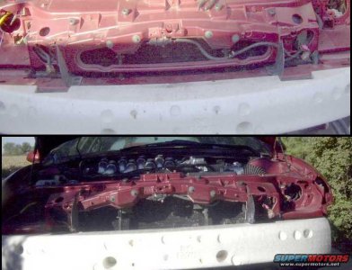

And here is something you can do to improve the air flow. This was done to the GEN4s from the factory.
Radiator support cut out
