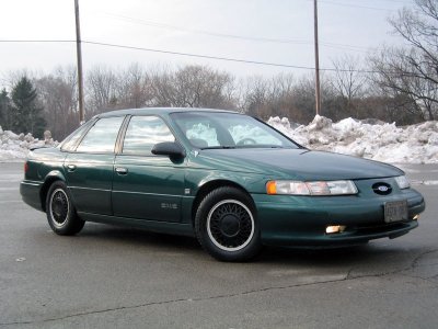

I chopped 2.5 springs off the front of my ATX to obtain this ride height:
SHO0809
I cut 1.5 off the rear, but on the wrong side and the springs started sagging in no time...
