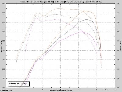

Yep (Gearhead) has turbo upgrades. I designed them to be max turbo for stock block applications without losing much spoolup/response compared to stock. I run them in my car. The below graphs are stock turbos at the bottom with tune, intercooler and downpipes. Then turbos on pump gas in the middle then turbos and e30 at the top.Ff61f8af7c09f5d5d133be07af82cd5b

I would vote that going from 400 whp to 460ish whp would be worth it...
