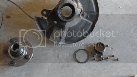

As I thought the Front wheel bearing was Toast on my 1995 SHO.
I realy don't think this is what it should look like, but I have been wrong in the past.
I will install the new bearing in the morning.

you are right, the little balls are supposed to be inside the bearing, not out on your driveway...
make sure you press on the right places when you assemble the new one, or you will get to do it again soon.

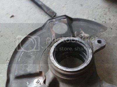

I stated earlier That I used an older bearing to get out the bearing on my wife Mystique and this is true. but in this case. the outer portion of the knuckle is different on my 95 SHO then my wife's Mystique. Same bearing, but the knuckle is set up differently.
I ended up Using a Chisel on the raised area of the outer bearing area and going in a Circular patten knocked the outer race out of the Knuckle.

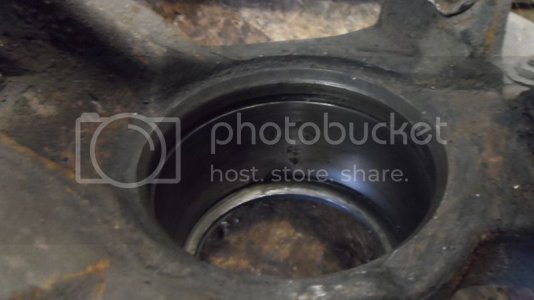

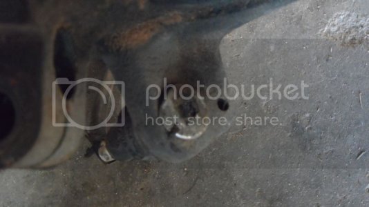

after I got it out I found What maybe the cause of this bearing to go bad it looks to me like some one may have torched out the original bearing a scored up the Knuckle some.
SAM 1229
I used my Die-grinder and a flat stone to relive the burrs slightly. just to be sure there were no areas to catch the bearing on the way back in.
