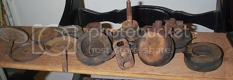

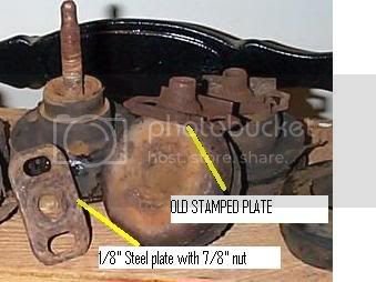

If yer lucky, your hardware will look something like this...
Bushings
Platenut
And you do NOT wanna put any of THAT back in your car when you can have THIS...
For a half tank of gas.
And it doesn't matter if you use aluminum or Gen3 subframe bushings(highly recommended), you will still need the recall kits because they come with the platenuts. You need at least 2 platenuts because even if the recall was done AND you are able to remove the two rear bolts without breaking the bolt off; keep in mind, the recall did not specify replacement of the FRONT plate nuts...just the rears...so you probably have 15 year old stamped steel platnuts up front.
Be prepared to do it right. You may not have a choice.
Edit: if the recall WAS done, there is a good chance you can get a 7/8" wrench on the platenut. This will help you save the hardware in back, but be prepared either way...notice one of my bolts broke off in the new style platenut.
