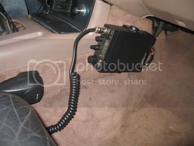

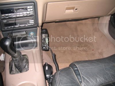

Cobra 19dx iv radio and a wilson 1000. Great setup. I also use mine with other friends that have cbs.
on my truck i have a cobra 29 classic with a 102" whip.

Holy crap that's a huge antenna! Both of them! :rofl:
I think the one I'm getting is a little smaller..... haha
I like were you mounted the radio on the side of the console like that. That's actually where I was thinking about mounting mine.

I also like that location. It's not in the way of the passenger's leg also.

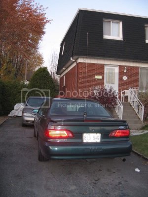

The antenna is a trunk mount wilson 1000. The whip is 54" tall. it's not THAT high. The whip is so thin up there that you barely notice it. I like the way it looks, and it's backed with good performance of the radio.
The range of a cb depends on the antenna. 80% of the performance of the setup come from the ant.
A cheap 20$ magnetic antenna will talk to the corner of the street.
Oh and btw, the end of the whip on my truck sits at 13' 7" off the ground! Now that's high!

The wilson 1000 antenna has 3 type of mount, magnet, trunk mount and roof mount (last one need to drill a hole in the sheet metal)
All of them can be removed under 5 seconds. The coil unscrews from the base, and you can also screw a wheater cap to prevent water infiltration if you plan to remove it for a while.
My next antenna will be a roof mounted, but installed on the center of the trunk (drilling a hole in the middle) for even better performance, and that way the antenna wont hit the sunroof if I open the trunk too fast.

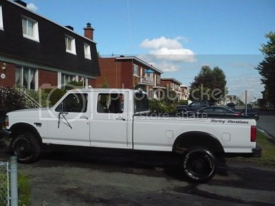

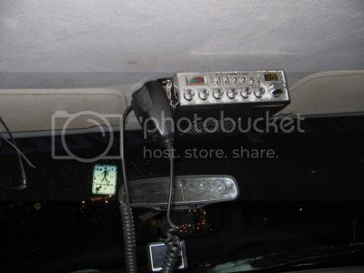

Here's my truck.
You can't see the end of the whip, but you get the idea. It does hit some trees and low powerlines, but after a year of use now, no sign of wear yet.
