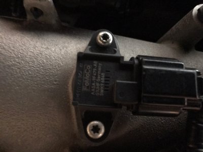

Not really softwarewise, it is a Ford-level initiative to figure that out. The dealer may be able to find out though how many times a tune has been flashed to the PCM. Does make for a crapshoot for a potential buyer. You could always insist that the PCM be flashed to the latest OEM tune before you buy?
Hardware-wise, if you see a 3 bar MAP atop the manifold, that would be a clue that the car is tuned. Up on a lift you can see if the downpipes are aftermarket, though the current tune may still be stock if the manifold MAP is 2 bar.

Shodded is correct... the only way to guarantee there is a tune is if there is a 3BAR map on the intake manifold and if the Downpipes don't have cats and there is no CEL from not having cats...
Not all dealerships take the time to update or flash the ECU... some just detail, change fluids (maybe!), and resell them...
Intake, exhaust, and even catted Downpipes don't necessarily need a tune.
