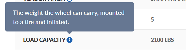

That would be the only thing I would double check with the wheels you're looking at, make sure they are load rated heavy enough for these cars
Thoughts?
  • WEIGHT
    25.08 lb
  • LOAD CAPACITY
    2100 lb

load capacity per wheel
1690906985381
From the FAQ's:
Velox forged wheels are at a minimum 2100lb load capacity with thicker rim and barrel sections to minimize deformation and enhance rigidity.

Okay yah you'll be good with 2100 per wheel.
Yeah our tanks are like 4300+ lbs - so yeah I originally thought I was good until you picked out some vendors rate by axel.

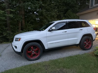

I don’t run staggered anymore but used to for about a year or so. Didn’t think it was really necessary so when I bought new wheels/tires I stopped doing it, never had any issue from it. Our cars aren’t AWD 100% of the time like Audi and Subaru. Used to be 20x9 all the way around 245/40/20 front and 275/35/20 rear with 1” spacers all around View attachment 88027

I do still have them but they’re powder coated red now and on my Gf’s Jeep with adapters to change the bolt pattern, plus they’re are also 1” Spacers Image
