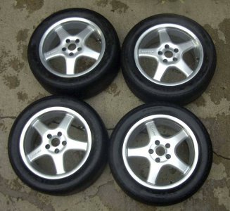

What style are you looking for? There is very little wiggle room for spacing and the rear suspension and fender. I would be looking to replicate the size and spacing of Chad's thunderbird Ford wheels. My old set fit and looked great. I would say find an aftermarket set 17x7 or 17x7.5 with the weird ford spacing and lug hole pattern. Tbird wheels were a replica of mustang cobra wheels with correct back spacing and lug pattern
Mustangs are 5x114.3, 24mm offset
Taurus wheels are 5x108, 42mm offset
also volvo wheels
Borbet all 4 jpg
Found this rando on the interwebs. Has some data you can extrapolate from. Measure twice buy once
