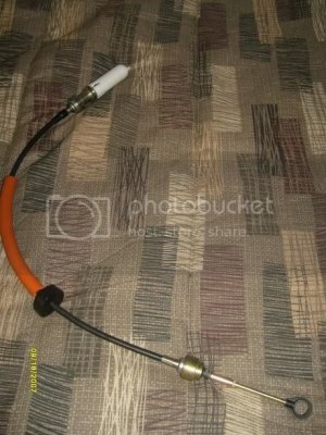

and yes...the black round platic piece that connects to the shifter is broken off..and i do have the part for it..now how would i go about installing it?
this is the new cable.
S7300719 1

alright..i tore apart the center console to take a look at the cable. looks like the guy who owned it before me had the same problem cus it was zip tied, and i see people do that as a quick fix. so how do i replace this cable? i got lucky i dont have to buy one because there was a brand new in the trunk still in the packaging.
