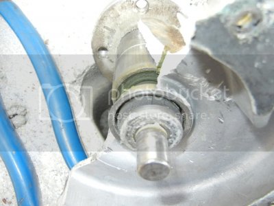

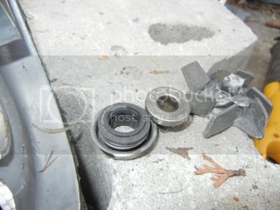

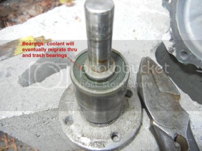

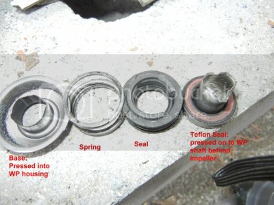

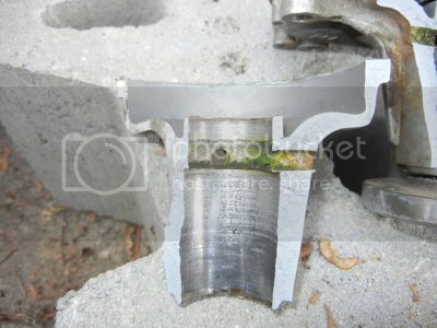

Got some free time before I go back to work, so I dismantled my old water pump to see what goes on. These waterpumps appear to be a really crappy design; either that or just poor material. The only thing stopping coolant from coming out of the weeping hole is some crappy (possibly rubber) seal, that has a separate spring tensioned teflon ring riding on it. My waterpump was 2-3 years old with low miles, and the rubber seal was extremely dried out, cracked all over, and extremely brittle. For anyone else who might have been curious, but just did not have the time or did not want to mangle their core; here are the pictures. Enjoy.

I pulled one apart last year and was shocked to notice that the only seal against the shaft and the mechanic seal is the metal sleeve there should be a o ring or sealant in there or there will always be a small amount pass there.

that is standard water pump design - how would you suggest to change it to make it better?
keep in mind you must have a decent bearing on the shaft to take the belt load and allow the shaft to spin. you also must have the impeller on the shaft and in the water. therefore you must have a seal on that shaft keeping the water out of the bearing. recognizing that even on the best seal, a little water will leak past, they put a weep hole in there to allow that coolant to (hopefully) drip out safely.
