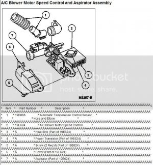

BTW, now that there's finally refrigerant, I started trying to figure out how to work the climate control system. I don't know if this is a problem or I am just doing something wrong, but when I set the A/C to any mode (Vent, Auto, Defrost, etc.) It won't let me choose a fan speed. The only way to get it to run is to turn the fan speed all the way up, then it's on full blast, but anything in the middle and it won't run at all. I thought the self test might have caught this sort of problem if it is one.

x2 on the Blower Control Module.
Do a search, you'll find a number of good threads on that as well.

+1 on blower control module. You're gonna need to replace this:
BCM
Fortunately, it's pretty easy to replace. It's under the glove box. Not behind it, under it. There is a plastic shield held on by two weird little wing-screw things. Just rip those off and it's right there.

From what I read, I think I just need to go find a BCM off a 93 Ford/Lincoln/Mercury somewhere and install it. I can get those pretty cheap right? ($30-$50)
