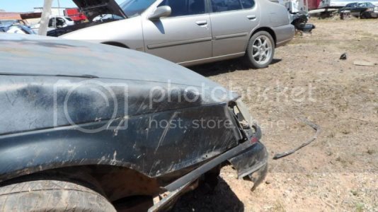

Well my wonderful wife did it again Just as I had almost gathered up enough materials to finis the Body work.
She Put her 1989 SHO in a Ditch a put it on its side when the right front wheel hit a driveway culvert and took out 16 feet and 3 post of ranch style Vinyl fencing.
Here are some preliminary shots of the damage I can see while it's on the ground no I did miss the roof damage hers did not have a sun roof before but I have a roof from another SHo with the Factory roof. I had other plans for it but if she wants it It will be BIG favors for it. if you check my prior post you may see that she put it through a fence about 3 years ago and guess what this is the same turn but 200 feet closer to the apex of the turn.
Normally this would be considered a total loss but I think most here will understand, This is her Baby and well She has Treated me Great and well I have the skills and well this is one reason I have them Not just because of Her no way. but because I like it, making some thing come back from the dead.

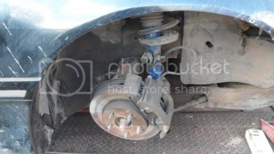

Question? I Have a 93 SHO parts car Will the rear spindle (knuckle) interchange with my 1989 The same question about the front Spindle. both right sides are messed up the rear one is snapped at the rear tie arm. man she did good she even popped out the strut out of the knuckle on the front.

The front spindle will work from the 93, but I believe the rear ones are specific to the 89.

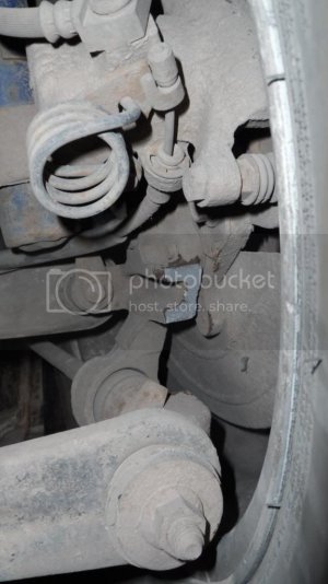

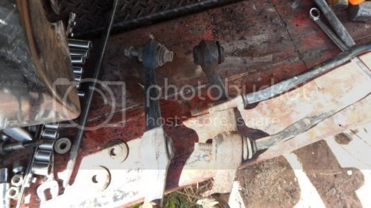

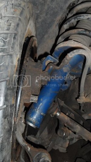

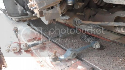

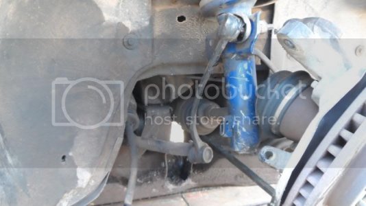

Here Are the latest shots
the front strut was pulled out of the the front knuckle, the lower control arm is now a pretzel. and the inner tie rod is a horse shoe.
5c47eebd fad8 45e5 ac24 4ed757239498
the rear knuckle snapped at the rear stamped connecting arm.
B244f83a fc0d 4878 90e2 9f8873aeb286
Still repairable. So far.

The rear. I think the main difference is just the hub, older ones didn't have the built in ring to mount the wheel hub-centrically.
Thank you!!! this is Great news!
I guess my best bet is to replace them in pairs to avoid problems.
Thank you for the feed back! :thankyou:

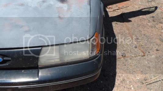

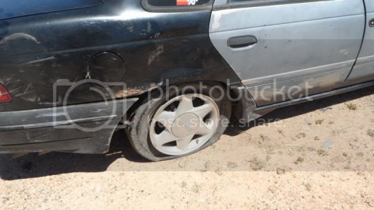

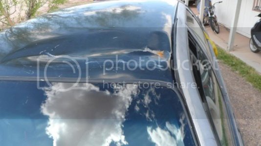

As promised Here is the roof damage. I STILL cant figure out how she took the front right fender out the right front suspension the rear suspension. no damage to the right doors put it on its right side but damaged the roof on the left drivers side. My babe wil never cease to amaze me. Got to love her though the car has saved here life twice I guess Resurrecting it shouldn't be a question.
This Roof Damage was from 1.5inch x 5.5inch x16 foot Vinyl fencing?
What the heck?

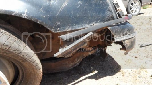

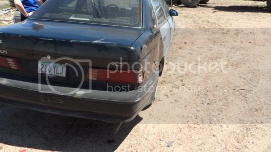

Here are More High lights from the fun
SAM 0880
SAM 0879

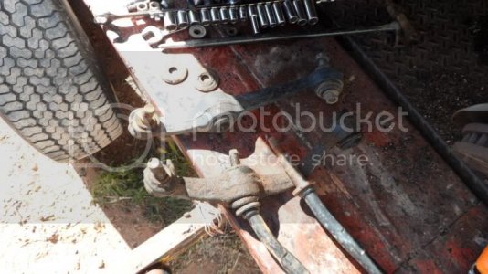

The new used part on bottom Hmm something is bent.
SAM 0877
SAM 0881
SAM 0878
Guess what I'm doing this summer. The sub frame is bent.
