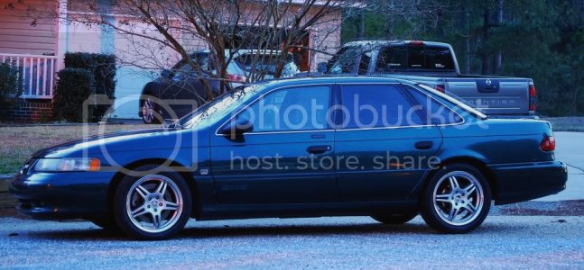

American Eagle Alloy Series 169 17" x 7 (IIRC) 40mm offset, long since discontinued (about 5 years now)

Alright guys, need some help - On a Gen 1 SHO, I'm looking at Voxx MG3 wheels and want 18x8 / 40 offset with 225/45/18 tire size. Will this work fine and clear ok in the rear?

On an 8 inch wheel i would go with a 235 or 245. A 235 will work ok on a gen 1 but i dont know if the 8 inch wheel will. 8 inches on a gen 1 might require rolling the fenders.

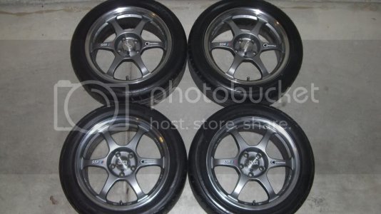

Just bought a set of Thunderbird SVTs. I'll join this club after i get them and my calipers powder coated.

Those look good, Sam! How many sets of wheels do you have now?
I'm thinkin' you are gonna be in trouble. In my pic above, it's a 7.5" with a 45mm offset. I believe I could have gone with an 8" rim with the 45mm offset, with no cutting. 40mm offset? Gonna be VERY close.
