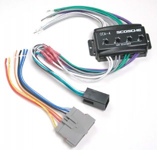

X142C4FDK5 f
I think that says it all.
http://www.crutchfield.com/cgi-bin/ProdView.asp?i=142C4FDK5
Unless you think the power amp built in the head unit is better than the JBL system's amp (not likely), I would go with this adapter from crutchfield for $39.
It does convert the head unit's speaker output into line level outputs for the stock amps which wouldn't be as good as using the head unit's RCA outputs to power an amp. Ford has no documentation of what level signal goes between the stock head unit and the amps. If it's a standard level, one might be able to splice RCAs into the stock amp audio signal cable and use the head unit's RCAs. I can't test whether this works though because the stock stereo (and the stupid chime module) got pulled out within days of me getting my car.
Even better of course is to rip out the entire stock stereo system and replace it with a good head unit, RCA cables back to a trunk of amps, and new speakers all around, not using any stock wiring. That kind of depends on your budget though...

You could cut the speaker output wires on the JBL main amp (all 8 of them). You could then hook up the head unit speaker outs to the speaker wire connectors behind the head unit (the adapter to do this is not shown in the kit above). Since the stock amp would no longer be connected to speakers, it would only be providing the subwoofer signal to the stock sub amp. Then splice in an adapter like the one above between the head unit speaker outs and the amp signal cable behind the dash. Got that? All four main speakers run off the head unit, and the sub runs of the JBL sub amp. The adapter's level controls would only control the level of the subwoofer.
